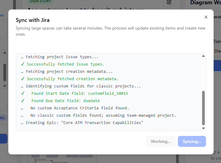

This feature exports the project plan from the app to your Jira instance. It will create new issues or update existing ones if they were previously synced.
- Click the Sync with Jira button in the main header.
- In the modal, paste your Jira API Token.
- Enter the Jira Project Key (e.g., “PROJ”) of the target project.
- (Optional) Acceptance Criteria Field: If your Jira project has a dedicated custom field for acceptance criteria, enter its ID here (e.g.,
customfield_10021
). This keeps the main description field cleaner. If left blank, acceptance criteria will be appended to the description of the Story. - Test Token: It’s highly recommended to click Test Token first to ensure your credentials are valid.
- Click Start Sync.
The log window will show the progress as the app creates or updates Epics, Stories, and Sub-Tasks. Once synced, the Jira Keys (e.g., “PROJ-123”) will appear next to the item titles in the hierarchy view. Diagram attachments will also be uploaded as SVG files to their corresponding Jira issues.
